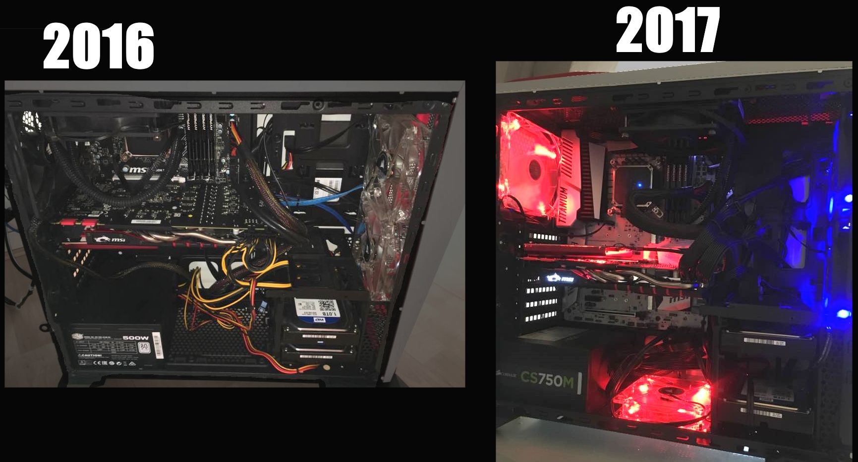

Just finished with some minor upgrades with my build, sharing the results.
SPECS & UPDATES
CPU: Intel i5 6400 @ 2.7GHz >>> (BCLK) Overclocked @ 4.3GHz
Motherboard: MSI B150M Bazooka >>> MSI Z170A MPower Gaming Titanium
Graphics: MSI GTX 980 Gaming 4G LE >>> Overclocked @ 1310-1411 MHz Core Clock, 7952 MHz Memory Clock
Memory: HyperX DDR4 16Gb 2133 Mhz >>> Overclocked @ 2666 Mhz
Storage: 2x150GB SSD (SATA), 2X1TB HDD
PSU: CoolerMaster 500W >>> Corsair 750 W
CPU Cooling: CoolerMaster Seidon 120V Watercooling
Case Cooling: 2x Front Panel + 1x Rear Panel Fans >>> 3x Front Panel + 1x Rear Panel + 1x Bottom Case Fans
Display: Samsung S24D340 @ 24" 1920x1080 >>> LG-29UM68 @ 29" 2560x1080
Dedicated Sound Card: Creative Sound Blaster Z (PCI-e)
Sound Systems: Logitech z506 5.1 Surround, Logitech G633 7.1 Headset
Peripherals: Logitech G502 Mouse, Some Chinese knockoff mechanical keyboard
